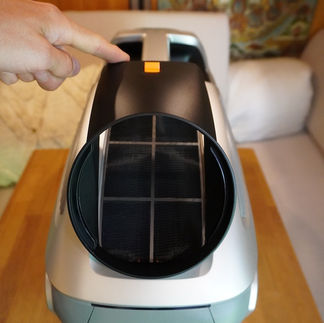

Setting up the ZERO BREEZE Mark 3
If you will be keeping the ZERO BREEZE OUTSIDE your van (and blowing air inside), you will attach the ducts to the front as shown below.
Attaching ducts to front
If you are keeping the ZERO BREEZE INSIDE the van (the most common setup), you will attach the ducts to the back as shown below.
Since I kept my ZERO BREEZE inside the van, that is the method I will show you here. Though the methodology is the exact same in both cases.
First you need to attach the plastic duct adapters to the air conditioner.
Here I show how to attach the top adapter:
And here I show how to attach the bottom adapter:
Once you have attached your adapters, go and grab your ducts (check out how far those things expand).
You then simply screw/twist the ducts onto the adapters and you're ready to go!
