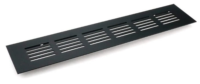

door vent
​Door vent
Allows air flow for the extractor fan

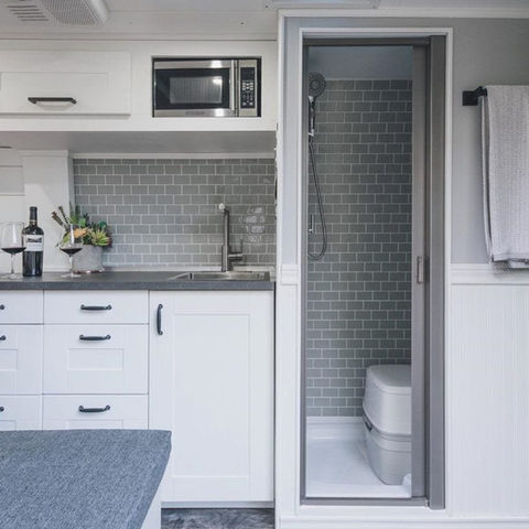

There are three popular locations for installing an indoor shower in a campervan. A picture paints a thousand words, so here are some photos to illustrate those locations.
  • LostOnTheRoute.com
  • @van_yacht
  • @the.activ
  • @eyesopen_vanlife_workshop

A quick note on tiling:
There are many methods of making waterproof shower walls. The PVC method described above is the most 'waterproof' method (and easiest). Another popular method is to tile the inside walls of the shower. Many of the 'prettiest' campervans use this method. However I will not be describing this method in this guide. However, LostOnTheRoute has a great blog describing how to do this.
Campervan shower with tiles

Ventilation: If your campervan shower door makes a really good seal, you are going to need to install a vent.
campervan shower door vent
Why? Well having an extractor fan is all well and good, but the air it extracts needs to come from somewhere.
To allow for proper ventilation of the campervan shower, install a vent somewhere low in the shower (the door would be the perfect place).
