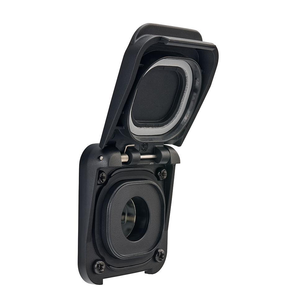

Or, if you want to go for the highest quality, Scanstrut also make an elegant and waterproof Flip Pro 12V cigarette outlet.
cigarette outlet 12v scanstreut
Scanstrut Flip Pro 12V cigarette outlet
A standard 12V socket is typically rated around 10-15 amps. Many automotive ones are fused at 15A, which means roughly 180 W max power (12V × 15A = 180W). In practice, I try not to pull the full 15A continuously, to avoid heating. Around 10A (120W) or so is a safe continuous load for things like a fridge or laptop charger. Quality matters here – a cheap socket might not make a tight connection, leading to voltage drop or heating (ever had a plug that felt hot or slipped out? That’s what we want to avoid!).
