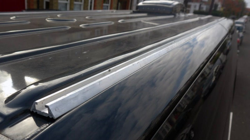

Installing a side ladder can actually be easier than a back ladder if you choose a model that mounts directly onto your van’s roof rails. Roof rails like these are a very useful van conversion addition, making for easy mounting of rigid solar panels or a roof rack. Once the roof rail is installed, the side ladder just slides into place.
Van conversion roof rail
Roof rails are an easy installation that make installing hardware on your roof much easier.
How to Install a Roof Rail on a Van
Step 1: Remove the rubber plugs running down the length of the roof troughs or grooves. Heat up the plugs with a heat gun, then pry them out with a flathead screwdriver or a pair of pliers.
how to install a roof rail on a van
Step 2: Add a small blob of silicone sealant or a piece of mastic tape over each hole to create a watertight seal.
Adding mastic tape to the bolt hole
Step 3: Bolt down the roof rail to the roof. The washer and nut are tightened from the inside of the van.
Offroad van ladder
Step 4: Finally, slide your side mounting ladder into your newly-installed roof rails.
