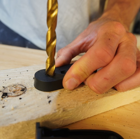

  1. Chill the rubber bung in the fridge before drilling — makes cleaner holes.
  2. Drill each hole 1.5 mm larger than the cable diameter so the seal compresses properly when tightened.
  3. Leave at least 4 mm between holes to maintain the seal’s integrity.

Step 1. Prepare the rubber bung
Put the bung in the fridge. Once chilled, drill holes to suit your cables, leaving 4 mm between each. Remember: 1.5 mm bigger than cable size.

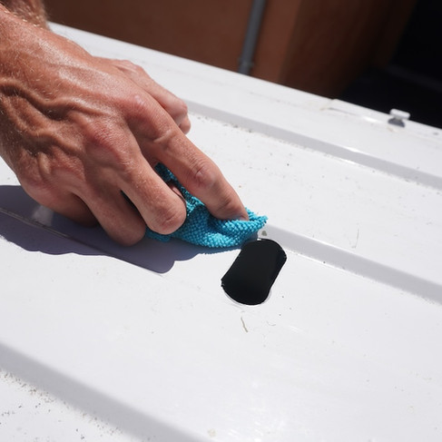

Step 5. Deburr & clean
File away burrs and sharp edges. Wipe clean with a microfibre cloth.
